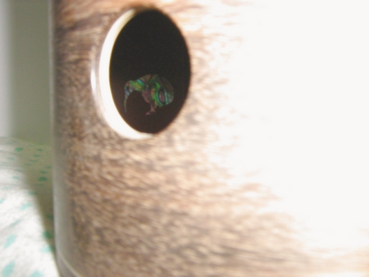

Here's a shot of my little Paua Kiwi inlaid into the neck block , viewable through the soundport

I'm just so floored with this one, and I was floored with your #1 as well. Everything about it exudes class and style. The laminated/purfled side braces, the Kiwi on the neckblock, the broken inlaid "purfling" on the neck, bridge, and headstock are too cool for words. Everything about this is expertly fitted and tastefully done. If I didn't know better, Id swear your last name was really Kinnaird or Klepper! I'm not sure how you can raise the bar any higher than you have, certainly I know of nobody's first and second instruments that I can put at this level. If it sounds as good and plays as good as it looks, it's a total winner.
